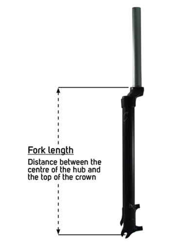

Many riders consider replacing a 120 mm suspension fork on a 29er with a rigid fork. During this process, it is common to notice a difference between the measured axle-to-crown (A-C) length of the old suspension fork and the new rigid fork. For example, a suspension fork may measure around 525 mm A-C, while a rigid fork designed for the same frame measures around 490 mm. On paper this appears to be a large 35 mm difference, but in practice it is usually exactly what the frame is designed for.

When a mechanic or rider compares fork lengths on the workstand, they are usually looking at:
  • Suspension fork: fully extended, no rider weight, for example 525 mm A-C.
  • Rigid fork: fixed length, for example 490 mm A-C.
This leads to the impression that the rigid fork will drop the front of the bike by the full 35 mm. On the trail, however, the suspension fork is not fully extended; it is partway into its travel due to sag. The frame and rider experience something much closer to 495 mm vs 490 mm, not 525 mm vs 490 mm.

A simple geometry check method
A straightforward way to understand the real-world geometry change is to measure a bike in its ridden state.
  1. With the suspension fork installed, set the fork to the normal air pressure or spring preload used on the trail.
  2. Place the bike on level ground.
  3. Have the rider adopt a typical riding position so the fork sags into its travel.
  4. Measure the A-C length from the centre of the front axle to the base of the crown while the rider remains on the bike.
  5. Compare this sagged A-C length to the rigid fork's A-C (for example, 490 mm).
This measurement often reveals that the sagged suspension fork is very close to the rigid fork's length. That is the essence of suspension correction.
