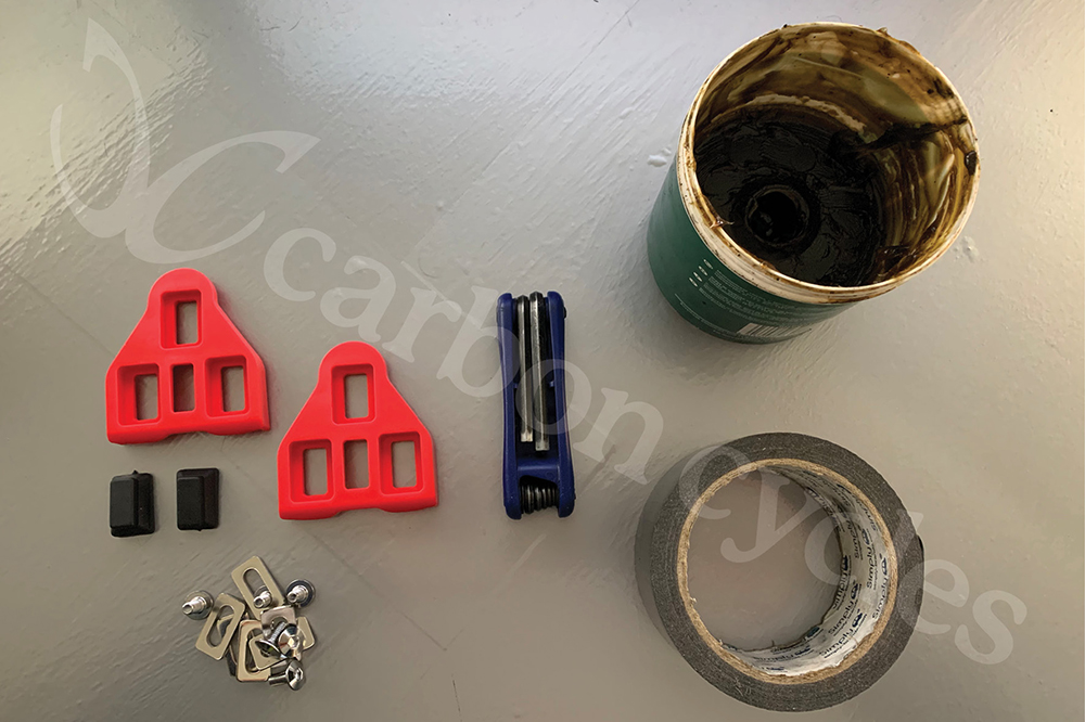

To replace your cleat and to keep a position of the new cleat that is as similar as possible to the one you are removing, you will need the following items: new cleat set (CC-CLEAT02 or CC-CLEAT04 - see exact contents below), including washers, bolts and rubber plug, an Allen key set, some tape (for marking) and some grease. The cleats are not left or right specific.
An exact list of items included:
- 2 x cleat
- 6 x washers
- 6 x bolts
- 2 x rubber plug (black)

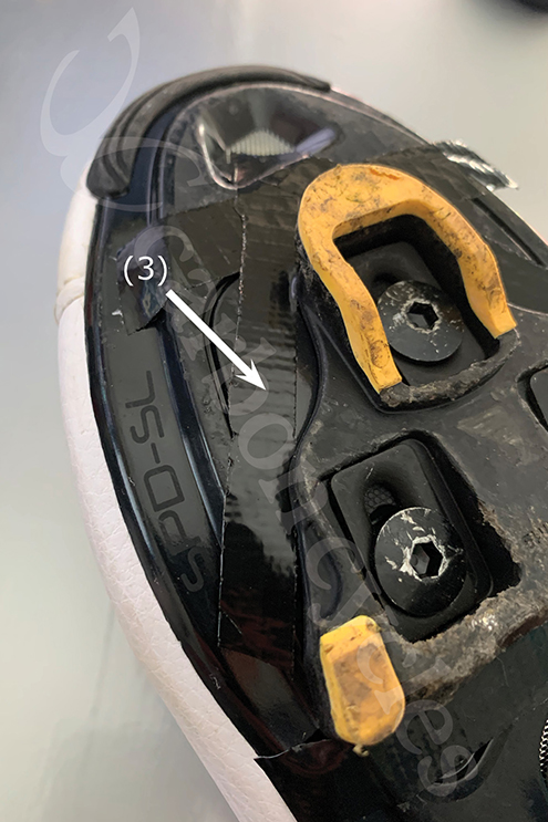

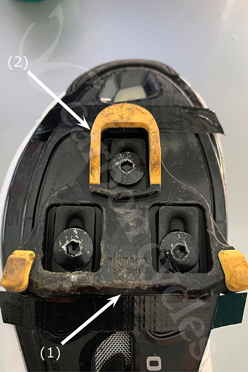

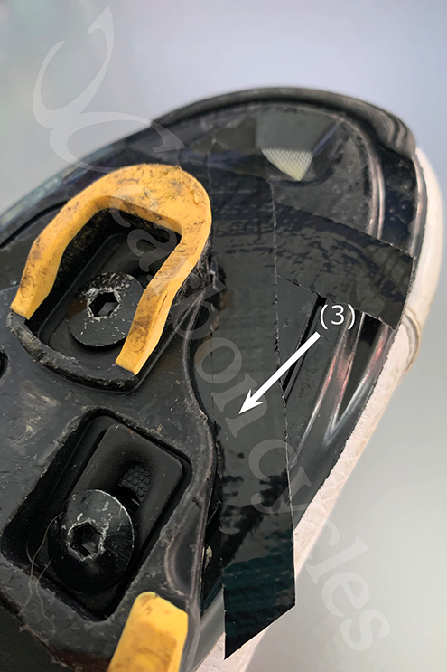

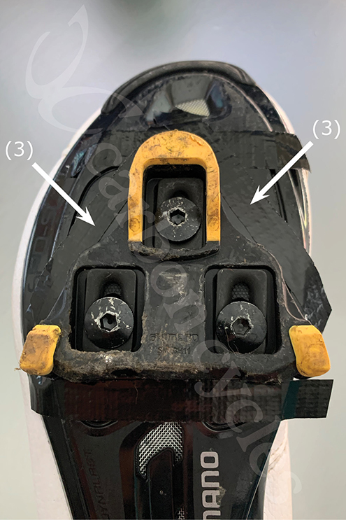

To help in keeping the proven position of your old cleat, we suggest using some strips of tape to mark the position. Start with putting a strip at the back of the old cleat (1) as well as the front (2). This will help to fit the new cleat in the same position on the base of the shoe. Now take two more strips and apply them along the sides of the cleat. The strips should mark the angle your old cleat is positioned, making it easier to install the new one in the same location. We are replacing two different pedal/cleat systems here, where the tape might be less accurate than if you are replacing with the same cleat, however, it should still give a very good indication of where your new cleat should sit. Repeat the same on your other shoe.
Remove the old cleat

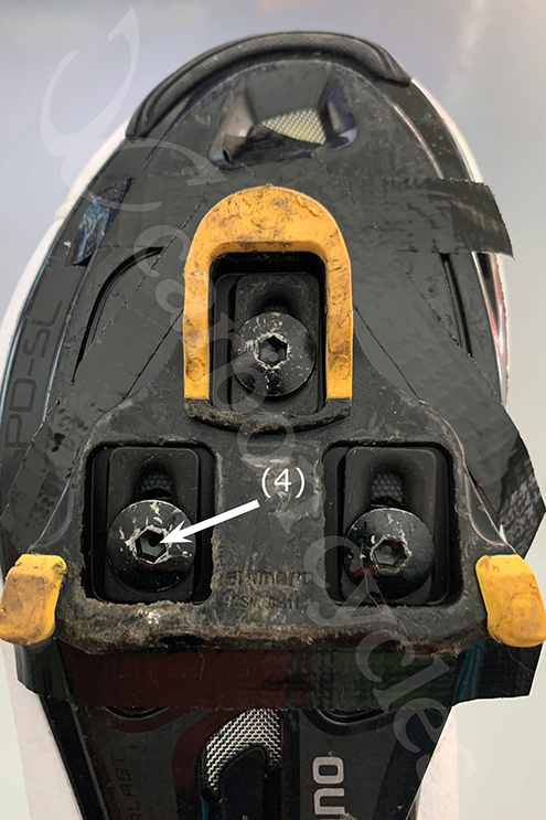

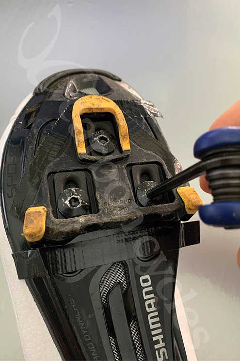

If needed, remove any debris from the centre of your old bolts (4) as that will make removing them much easier. Use a quality Allen key to remove the bolts. Make sure you don't round off the bolts in the process as that will also make the removing much more difficult. Turn the bolts anti-clockwise till they are all out and you can remove the old cleat. Repeat the same on your other shoe.

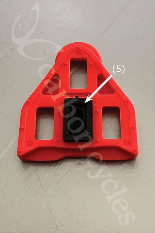

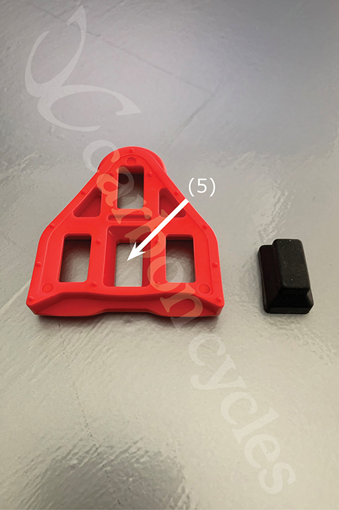

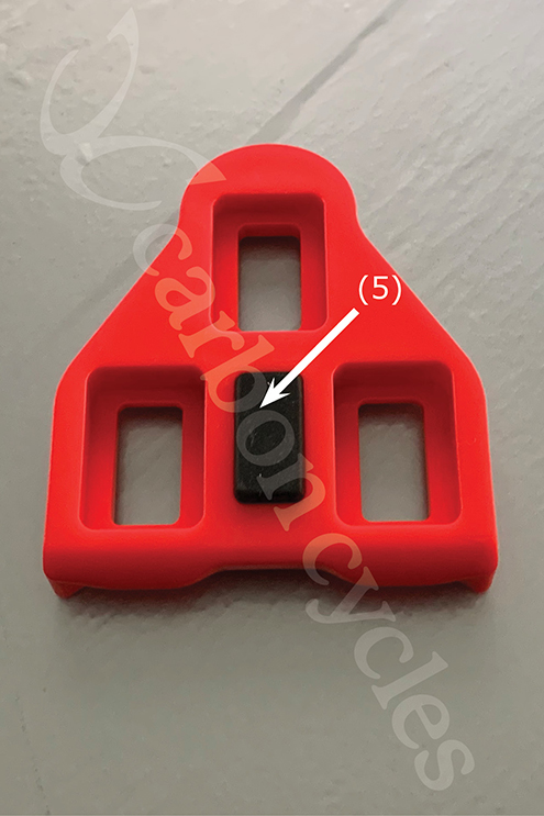

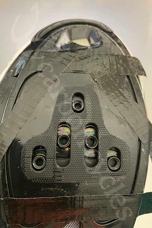

Clean the base of your shoe and make sure that no dirt gets into the bolt holes. Put the black rubber plug into the central hole of the cleat (position 5). Repeat the same on your other shoe.

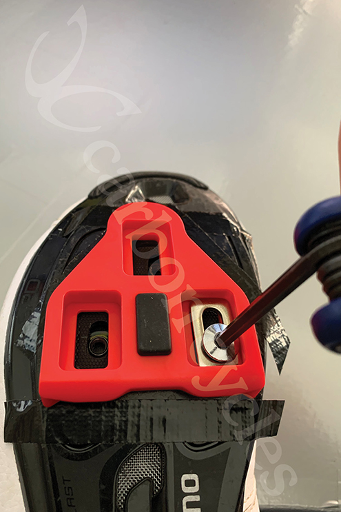

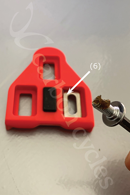

Give each bolt a thin coating of grease. Put a washer ((6) - with the slightly sharper edge facing towards the sole of the shoe) into the cleat and feed the bolt through the washer into the bolt hole. Slightly tighten. Repeat on all three holes. Repeat the same on your other shoe.
Check the position of the new cleat

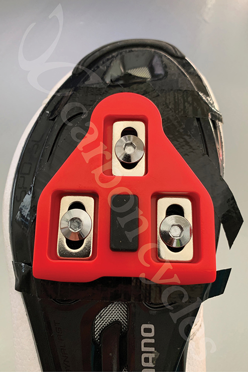

Before tightening down, please check the position of the cleat with the help of the tape and secure each bolt by turning it clock-wise. Don't fully tighten down one bolt, before you go to the next. Instead, incrementally tighten the bolts, going from one to the next, each time tightening the bolt a little bit further till they are all nice and tight. Please make sure you don't overtighten the bolts and potentially damage the cleat or your shoe. Repeat the same on your other shoe. Before removing the tape, go for a short ride to check that the position of the cleat is as you would like it to be. Once you have confirmed the right position, you can remove the tape and use your new cleats.
