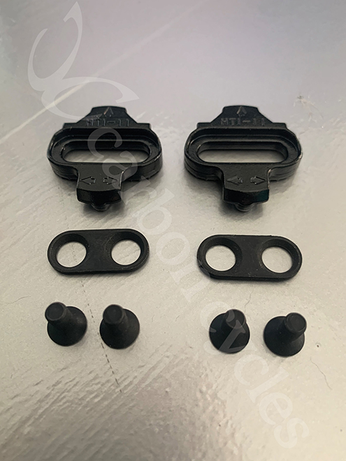

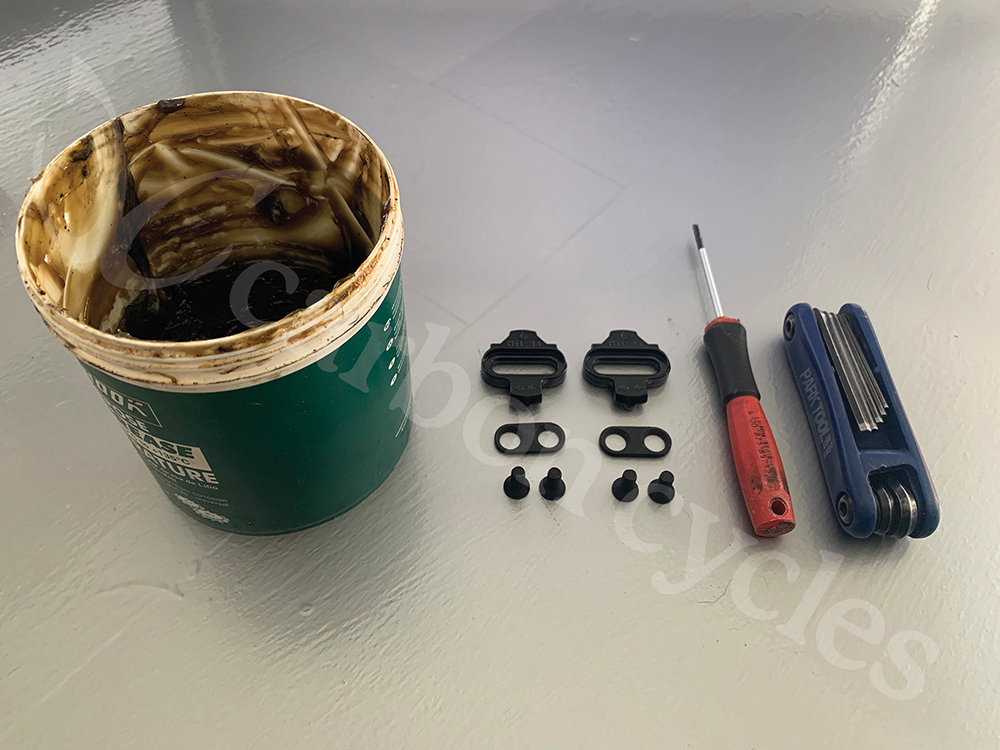

To replace your cleat and to keep a position of the new cleat that is as similar as possible to the one you are removing, you will need the following items: new cleat set (CC-CLEAT03 - see exact contents below), including washers and bolts, an Allen key set, a sharp-edged tool (for example little screwdriver) and some grease. The cleats are not left or right specific.
Exact list of items included:
- 2 x cleats
- 2 x washers / washerplates
- 4 x bolts

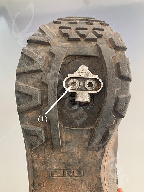

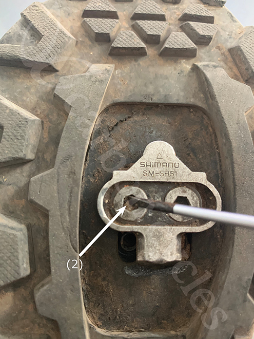

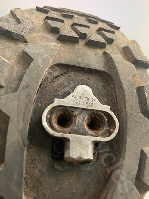

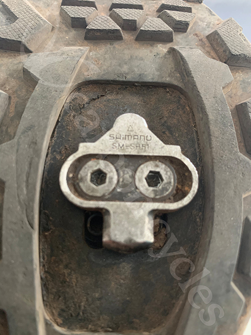

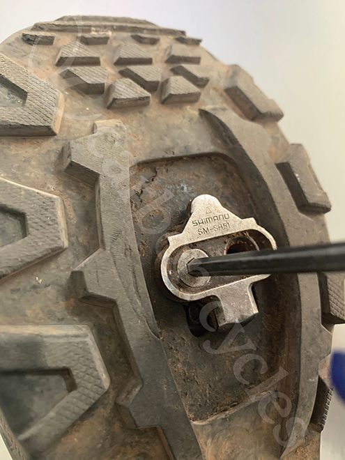

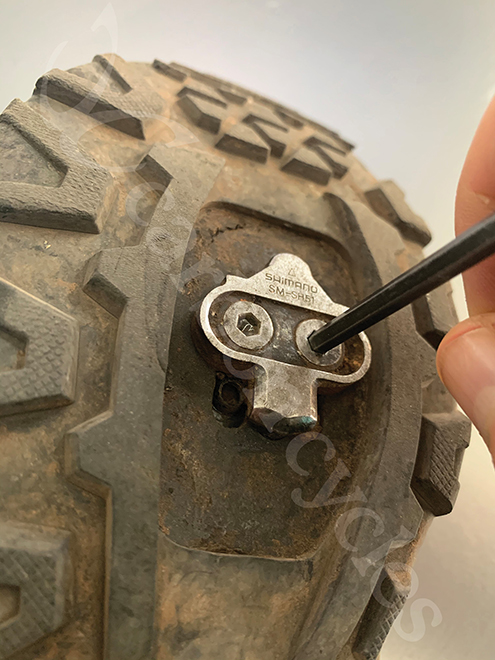

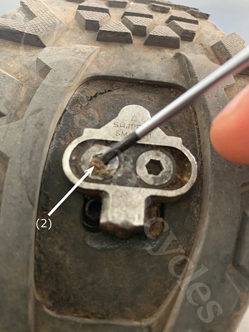

It often happens that dirt and grit gets into the Allen key head of the bolt (1). To prevent rounding off the bolt, or damage your Allen key set, we would suggest removing all dirt and grit from the head (2) with a sharp-edged tool, like for example a small screwdriver. Use a quality Allen key to remove the bolts. Make sure you don't round off the bolts in the process as that will also make the removing much more difficult. Turn the bolts anti-clockwise till they are all out and you can remove the old cleat.

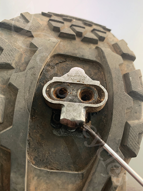

Most likely, you need to leaver the cleat gently off the sole of the shoe. Once again use a sharp-edged tool like a screwdriver to do this. Repeat the same on your other shoe.

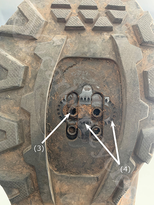

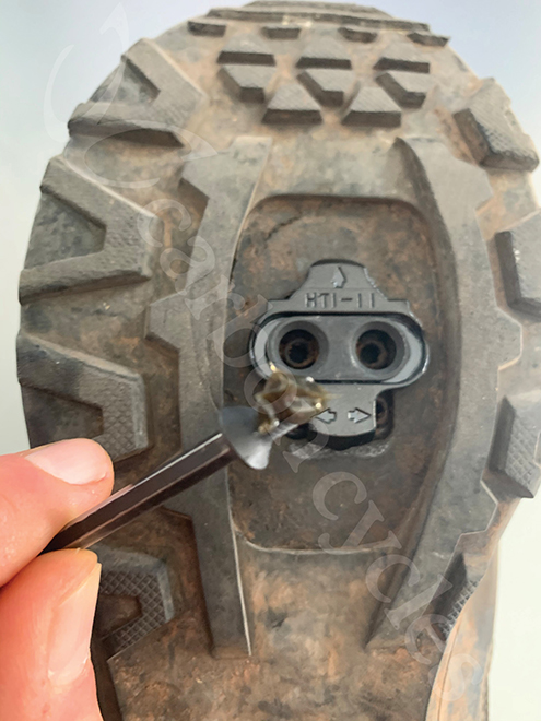

Clean the base of your shoe and make sure that no dirt gets into the bolt holes. To make it easier to fit the new cleat in the same position as the old one, please be careful when cleaning that the bolt plate (which sits inside the shoe (3)) moves. The old cleat will have left markings/indents (4) which will help to install the new cleat in the same position. Repeat the same on your other shoe.

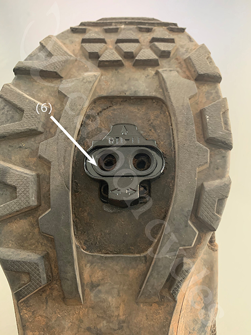

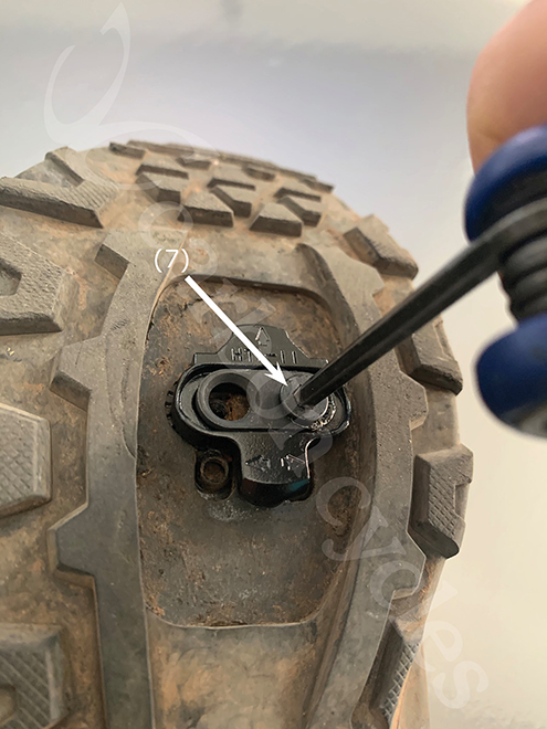

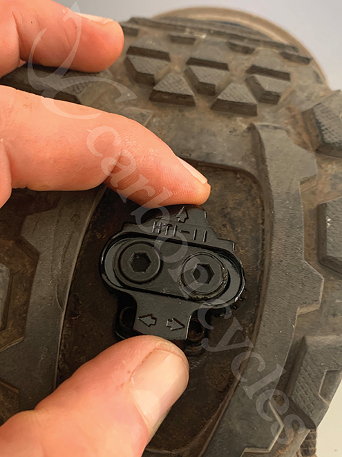

Place the new cleat roughly in the position where the old one was, and over the bolt holes you are going to screw the bolts into. Make sure that the little arrow (5) points towards the front of the shoe. Place the washer/washerplate into the cleat. Make sure that the side with countersunk holes, which lets the bolts sit flush with the washer, points upwards (6). Give each bolt a thin coating of grease and feed the bolt through the washer into the bolt hole (7). Slightly tighten. Repeat on both holes. Repeat the same on your other shoe.

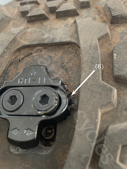

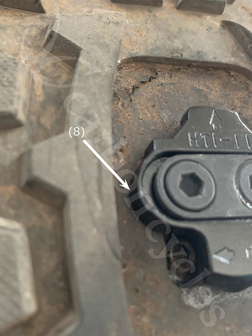

Before tightening down, please check the markings your 'old' cleat left ( 8 ), so that the position of your new cleat is as similar to the 'old' one as possible. Adjust the position of the cleat till the markings confirm that the position is the same. Once in the right position, secure each bolt by turning it clockwise. It helps if you securely hold the cleat with one hand so that the process of tightening it down does not move the cleat. Don't fully tighten down one bolt, before you go to the next. Instead, incrementally tighten the bolts, going from one to the other, each time tightening the bolt a little bit further till they are all nice and tight. Please make sure you don't overtighten the bolts and potentially damage the cleat or your shoe. Repeat the same on your other shoe. Go for a short ride to check that the position of the cleat is as you would like it to be.
